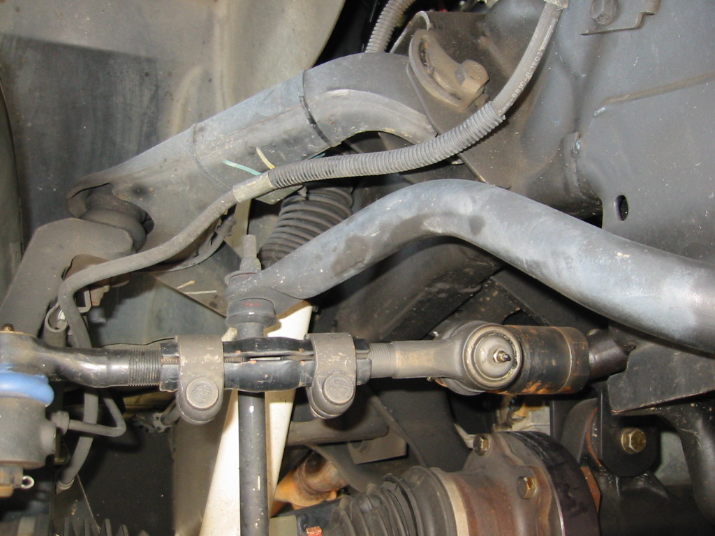

Travis did his RubberDuck fix on my truck... Note it's a new application for him, 4" Rancho..
Great guy, quality work!!!!

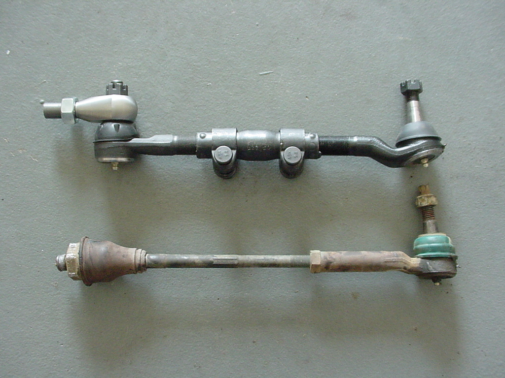

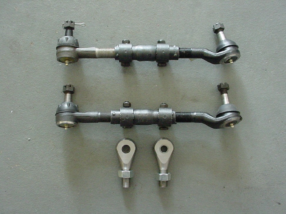

More pics of RubberDuck's 'standard' Heavy Duty Set...
- Shannon

Compared the the factory tie rod...
- Shannon

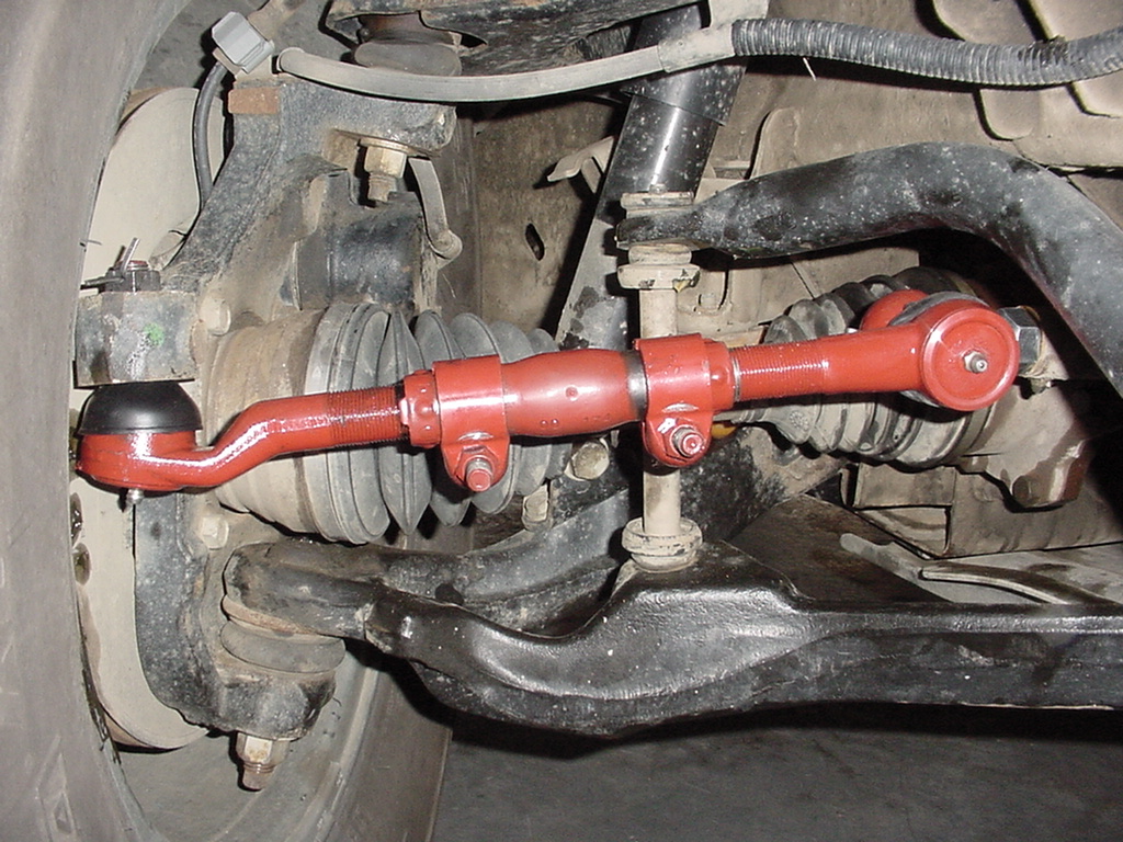

Installed on a non-lifted truck...
- Shannon

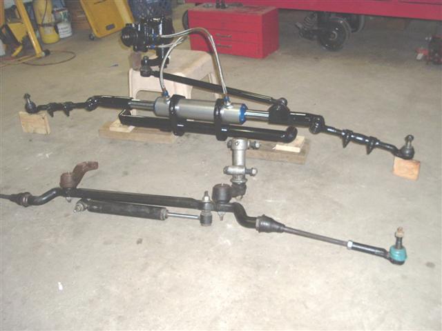

I would be interested in hearing how the FST rodends hold up and how fast they wear. I considered using spherical rodends (heim joints) for this hydro-assist set-up I just finished for my H2, but was worried they wouldn't last as long as the Rubberduck tierod ends.
All of the stock tierods, idler arm, pitman arm and stabilizer in the foreground are now not used.

hummie2
that setup looks sweet, have any more info?
Old 11-10-2004, 01:40 AM
Hummie2's Avatar
Hummie2 Hummie2 is offline
Location: La Porte,TX
Posts: 391
Hummie2 is an unknown quantity at this point
HummerLV...
Its one of my creations. I used Rubberduck tierods and machined some adapters to fit them to the ram which I special ordered from Performance Off-road Systems. The cylinder is a 2 1/2" bore X 6 1/2" stroke balanced unit with induction hardened 1 1/2" rods, should be nearly impossible to bend them. The pitman arm is a chromemoly piece from Borgenson. I fabricated the crossmember from 1 3/4" x .250 wall DOM mechanical tube and it uses existing frame holes to mount it up. I can return everything back to stock fairly easy should I ever decide to. I've got about a month of free time fitting, fabricating, welding, machining everything and about $1500 in parts in the job. Still have a little work left to do to get everything dialed in right, but it looks like it holds some promise. I will let you know more when I get some more road miles and a few off-road trips on it.
