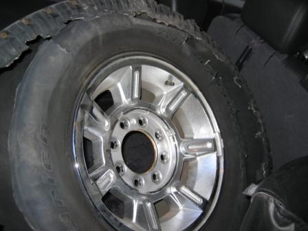

Got a call from the spousal unit the other day at work. The left rear tire on the '05 H2 went flat very quickly. She was stuck on the side of the road and needed assistance to change the tire.
So, tire-changer guy shows up and finds the tire (stock wheels and tires with less than 4000 miles since new) with it's sidewall completely ripped up. This was not a tire flat; rather it was a tire failure and caused a dangerous situation. I'll post a pic for the curious - out of town right now.
Wanted to check though: has anybody had stock tires blow out on them? As I said the sidewall was completely ripped up all the way around. I've never seen a tire fail this way - especially one that is basically new.
Tire-guy (specialist) could hardly change the wheel. Apparently it weighs a ton! Sounds like it is a two-man job.

It sounds like the tire lost air, then overheated with the sidewall taking the brunt of it.
I've seen it happen on my 2000 BMW's rear tire before. Really nasty.
As for the weight. The tires are not light, and the whole combination is pretty beefy. It's not as heavy as some of the tires I mount all the time (38x15.5Rx16.5 on 2 piece steel rims with beadlocks, which are about 180lbs each), but it's still sizeable. I'd say it about 110 lbs or so

thanks for the comments guys. Seems that the other thread I started is not going anywhere. I'm looking into possibly getting another set of wheels/tires that I could put on the truck that would be safer for everyday street/highway use. Here is a photo of the offending tire.

Green, I had that once in my Audi. Even the cop that pulled over and helped shine a light while I changed the tire was surprised to see it. Never happened again. So I agree it's prob just a bad tire/fluke.

I agree scary, but a fluke all the same.
