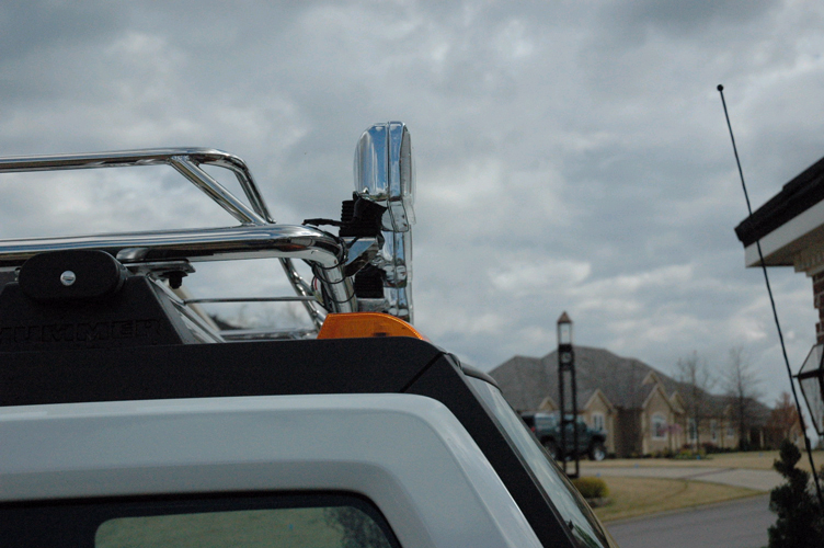

Here is a picture of the set up from the side. How much farther back? I think these are driving lights not fog or spot lights. What do you think?

Sorry, I guess I need to learn to post pictures. Any help from you guys?

The edge of your roofline needs to block the glare from your lights. Your lights need to be moved back or back and down enough to where there is no glare coming from the hood and especially so that there is no light able to come straight down on to the windshield.

Thanks. I will give it a try. I have to move the whole rack back to accomplish. Thanks.

Thanks for all the help. I got it fixed. Look closely at the lights, they are pointed down and with a small adjustment, the problem went away.

The edge of your roofline needs to block the glare from your lights. Your lights need to be moved back or back and down enough to where there is no glare coming from the hood and especially so that there is no light able to come straight down on to the windshield. </div></BLOCKQUOTE>
Yep!! What he said.
If you could somehow flip the mounting brackets so they were facing backwards that should be enough to keep the glare off of your windshield.
