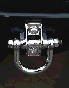

Hey Guys,
Personally I'm not a fan of chrome, but if you are that’s fine. Just a warning though, be careful what you Chrome. The Chroming process makes metal brittle, so definitely stay away from chroming items like the Tow Hooks shown, trailer hitches, and suspension parts. If the part you want to Chrome would put your or your family’s life at risk if it broke/let go, consider skipping the idea. Just an FYI, FWIW….
