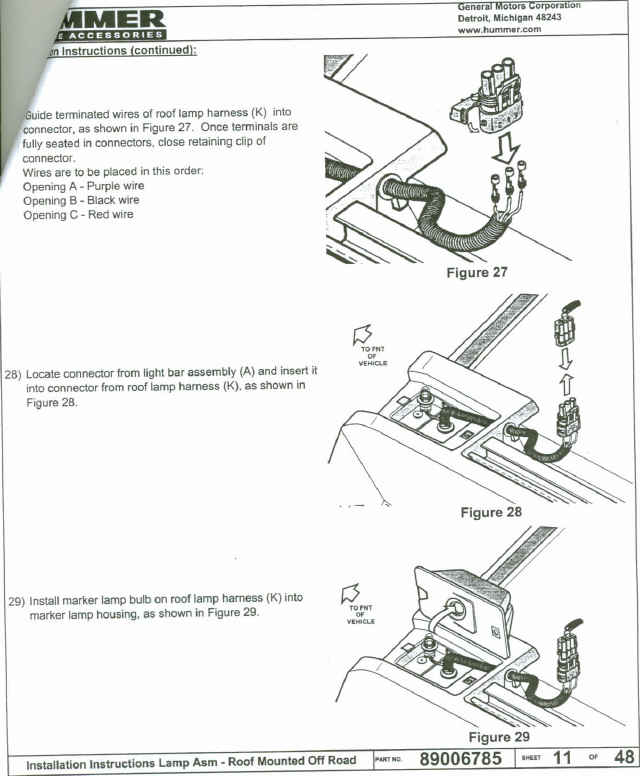

I know that many of you have run wires thru your running lights.. Did you run them underneath the light or drill a hole thru the lens. I was thinking to do the later. I believe that drilling in to the lens and then applying silicone would give a better seal.

Centerfire,
I just wired up a roof rack light bar. I ran the wire harness out under the base of the driverside roof light. If you look you will see a cut-out on the rear of the base of the driver side roof light. You don't need to drill a hole in the lense or run the wire under the lense. Take the lense off and run your wire through the access hole inside the light base and then route your wire towards the rear of the base through the cut-out. You will need to silicone the opening you make through the gasket seal over the access hole after you run your wires. I was lucky the wire harness that comes with the roof light bar comes with a new access hole gromett/gasket built right into it to replace the one that it already in there.

Neat.. I wonder if all the lights on top have the same spot.. Because I have to wire 4 Piaa 520's( which I believe will be set up with only one switch) and 2 @ 39" 911Ep LED's each having 5 wires in a cable, which will need to be wired to 3 -5 switches.. It will be interesting.. All in all I will need to hook up apprx 8 switches not including the siren.. I am waiting for all the stuff to show up because I want to take it apart only one time.. Cause I really do not like working on cars.
I may end up doing what I did to my Sub. I attached a pelican case on the roof rack . Put in most of my electronics ( strobe packs) in the case and only had to run hot and ground wire to switch. Hell I don't know =. I may just bribe one of the guys at the Sheriffs garage. If I can find one that is concerned with cosmetics as well as function.

Here is a copy of the roof rack light bar installation instructions diagraming the roof light base and the rear cut-out in the base. Pay particular attention to figure 29. The large thick black wire is the route I recommend you take to run your wires.

I think only the 2 outer roof lights are set up like this. The 3 lights in the middle do not appear to have bases that you can run wires from.
