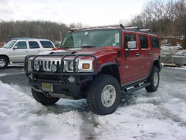

Here is the front of the truck. The first pics just shows the dash strobe. As you can see, it is barely visible. Also, off topic, you can see the SMA HD Brush Gaurd, SMA Valance w/ PIAA 520's, PIAA 525's on the gaurd, and the extreme tube on the roof.

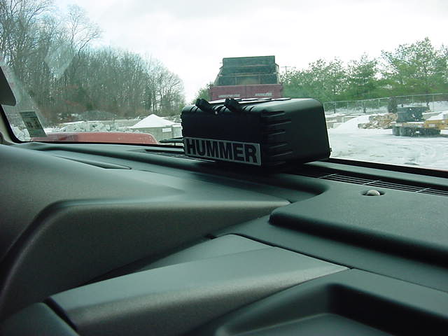

Here is the dash strobe. I removed the stickers and the switches. I placed a piece of aluminum on the holes and made sure I knew what kind of truck I was driving with the sticker! I also ran the wires out the bottom and shaved the front angle off of the housing to fit the flat windshield. The defrost works fine
