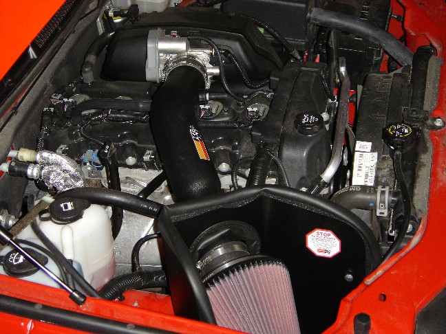

K&N installed!!!!!!!!!!!!
Took about 45 min. I had no adverse affect with the engine nor did I get any instrument lights on the Drivers instrument cluster. All is great!
The engine looks a lil strange witout that air box and air resenator that has that logo Vortec 3500 on it. Make sure that the hole on the side facing towards you is capped off completely. This hole is for the fuel vent thats normally found on the GMC Canyon or Chevy Colorado. K&N has a plug for that hole Hummers that dont use it. (K&N Part #63-1095) Maybe thats a possibility of why you are getting indicators on your instrument cluster?

Here is a picture of my newest upgrade!
K&N Air intake (Part# 63-1095)
