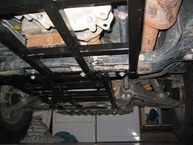

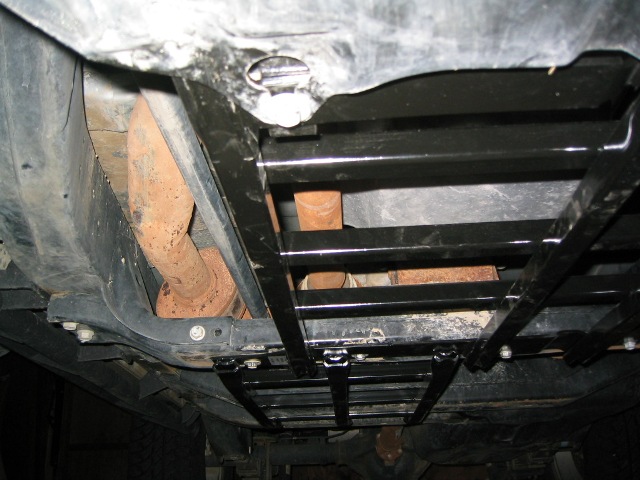

Here's a couple pics I took when installing the UC protection, sorry no action shots. It may not be as beefy as the RB stuff for the H2, but its all that's out there right now AFAIK. It does feel pretty sturdy. And it definitely beats the stock protection over the TC.

Sewie, thanks for the pics. Were they easy to put on? Any pitfalls in the installation that I need to avoid? Thank you.
Old 01-26-2006, 10:46 PM
The install was pretty easy. The only problem I had was that my dealer had replaced one of the skidplate bolts with a shorter one. So I was playing musical bolts to get everything to fit.
Old 01-26-2006, 10:48 PM
A couple other items of note.
1. You lose about 1" of clearance. Would be nice to have ones that tucked up between the crossmembers.
2. They collect mud like a mofo!

After you've had a few weeks to test them out... what do you think of them?
Is it worth the 1" loss in clearance??
  #37
Old 02-26-2006, 03:38 AM
FormerJeeper FormerJeeper is offline
Location: San Francisco
Posts: 192
FormerJeeper is off the scale
Seems a hell of a lot of money for what is essentially 1" or so box section steel.
IMHO, it would be better to use this type of ladder framework and then add 1/4" plate over the top of it.
I know when we used to armor Jeeps for trails like Rubicon the thought of leaving stuff open like in these picures is less than ideal.
