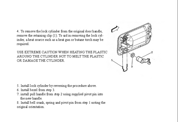

i hope this helps

Thanks Vip808, worked out great, the handles were tight and would not return to the closed position when released, perfect now.
