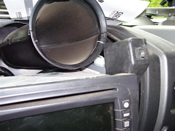

junk says that they are incompatible, but I don't know. I have all my stuff "hooked up and installed" but I haven't even begun to put things back together.
I don't have a sunroof and am trying to track down the sunroof relay so I can steal it's use for things since it's on the RAP circuit. I've got so much wire stuffed around the I/P fuse panel that I can't get to the fuses.
BTW, you can double-sided-tape the Sirius tuner on the PS of the radio just outside of the center I/P compartment. I did it w/o removing all of the top and PS dash, but it would make it easier if you did. There is enough length to the antenna wire to run it anywhere you want. Bringing wire down through the DS clearance light is the easiest, IMO.

07-28-2006, 02:34 AM
Re: SIR GM1
if you look, you can see the connector on the other side of the radio
That's where I was able to put the Sirius tuner.
