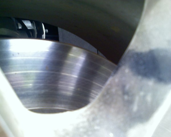

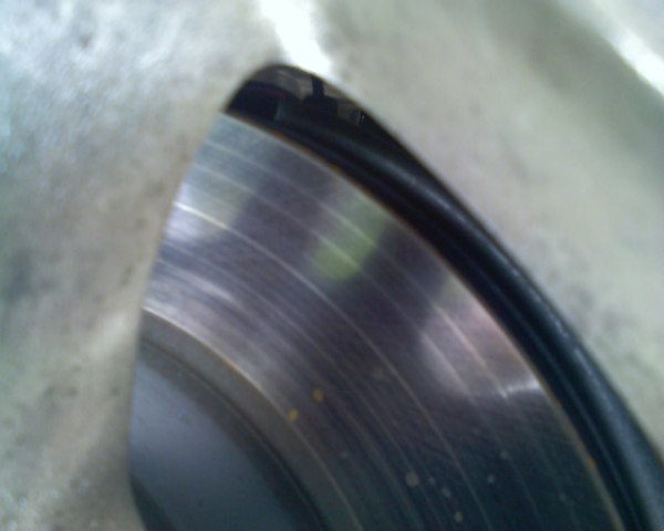

250 miles, still the same annoying ass noise. getting close up to the rotors I can see a few little grooves in them? If I drag my finger across the surface of the rotor I can feel a slight groove/channel/cut (for lack of words) is below the surface. Does this point to or part of the noise I am hearing all the time?
