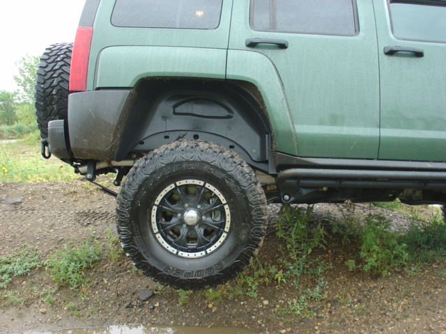

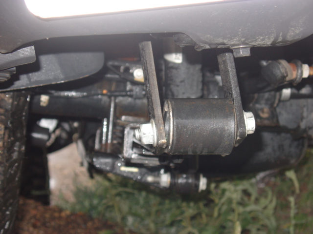

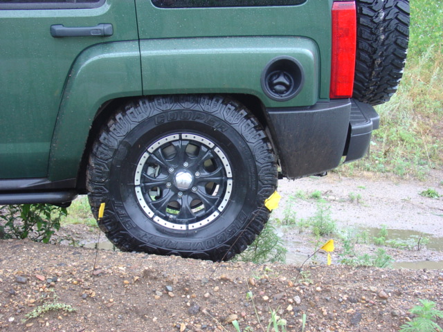

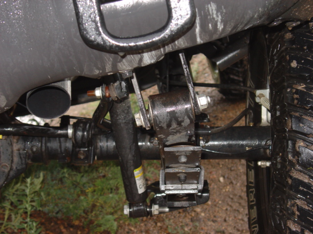

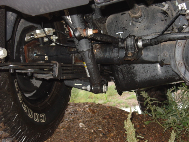

Pics of truck on test track with extended shackles. Fully tucked, fully extended, articulated spring and shackle.
All this talk about lifts and adjusting the torsion bars I am kind of supprised noone has been talking about sway bar disconnects.

Pics look good. Seems like it might be a good idea to put a support bar between the two sides of the shackle? It looks like it deflects and a support bar might prevent any problems.
Also, on the front IFS, would a sway bar disconnect really matter? Seems like suspension travel would be limited by the upper & lower arms, not the sway bar (like in a SFA).
For the rear, might be a good idea, when you flex out the rear suspension, does the sway bar limit travel down or is it the leaf springs. W/longer shackles, the sway bar might become the limiting factor (or shocks). I guess I have to get the hummer out and flex the crap out of the rear and see.

Only thing I am trying to do is level the truck and give it a hair more lift in the most cost effective manner. When all is said and done I should have an inch or 2 over stock, level truck, better articulation in rear, and the same relative ride quality for under $200.
