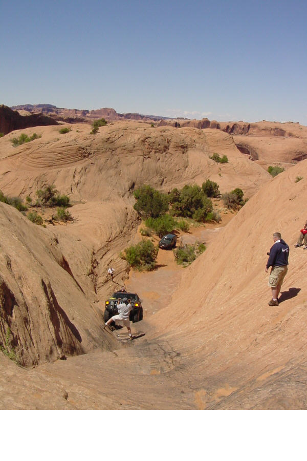

Just got back home last night so here are a few more pictures from Hell's Revenge. There are some really good shots of the H3's. I got some really good color so I thought some of you may want to download these for yourselves.

Neo going down the trail to get to Hell's Gate.
04-24-2006, 02:25 PM
Join Date: Dec 2003
Location: Midwest
Posts: 122
Coming up Hell's Gate

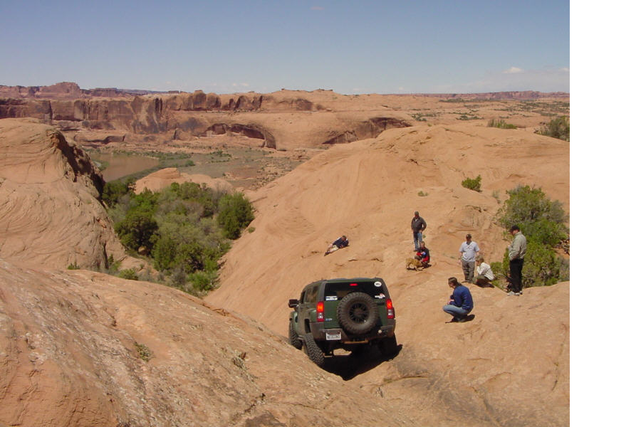

Bebe coming up Hell's Gate

Neo right after Hell's Gate. I love this shot!
