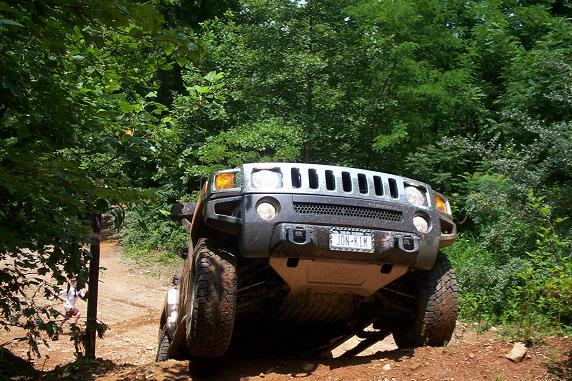

I wheel with mudflaps and steps,I just limit myself and know when to back up only got a small scuff on bottom of steps on this hill no big deal.
