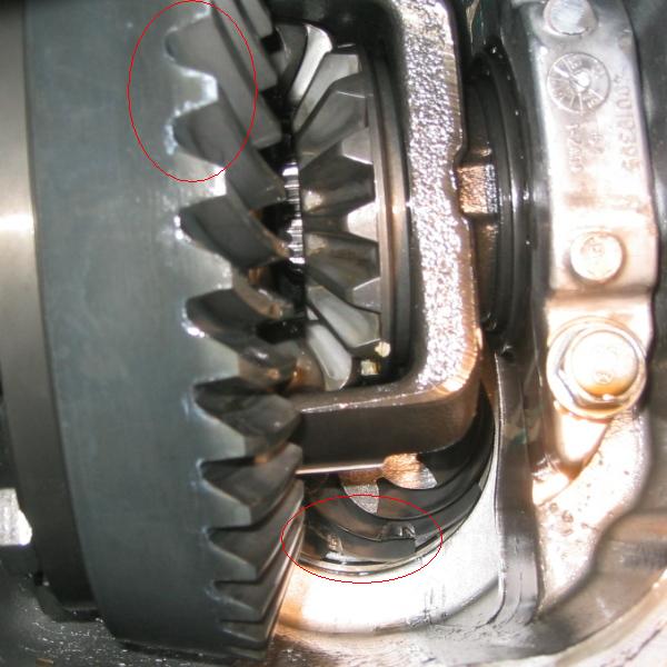

Default Re: Third Diff's a Charm
I also went back to look at the diff. You can see the damage to the pinion gear and some wear on the ring gear.
The tech is the same guy that worked on it last time. Since I didn't get to see the damage last time I asked him about it. He said there were chips on both the ring and pinion gears last time, on multiple teeth. They replaced the whole diff last time, housing and all.

OK, let me just say that Hummer Customer Assistance ROCKS!!!!
So I called up and said I wanted to open up a case since my truck was in for a second diff failure. The lady took my info and said she'd put me on hold while she called the service manager. A couple minutes later she comes back online and tells me everything will be covered under warranty, she'll check back in with me on Monday, and they'll compensate me for the inconvenience. She said they just want me to be completely satisfied. The whole call took less than 10 minutes.
BTW, I don't really blame the dealership. They suggested I call so we could get past the area GM rep and speed up the process. The service manager had no problem doing the work under warranty.
