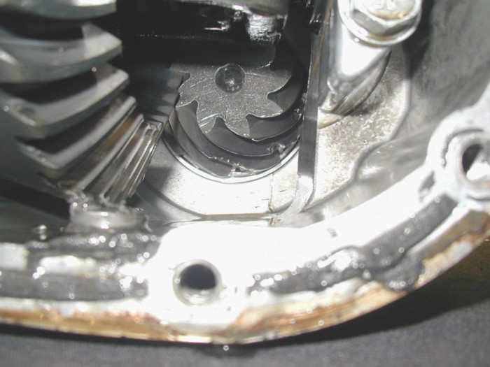

Old 09-28-2006, 06:31 AM
Default Re: Front Differential AND Driveline
OK here is a pic of the latest carnage:
