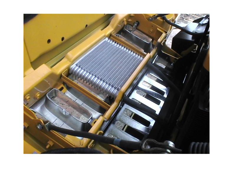

I finally got time to post -
I looped the tranny section of the radiator with a hose, closing it and elimanating the possible of the pepto bismal effect ever happening again.
With the information provided by Phil D (Thanks you the man) I purchased the larger of the 2 cooler Tru cooler #4739-1. I easily mounted it slightly off center towards the passenger side of the rig leaving the power steeering cooler in it's place.
The tranny now runs consistently at 150 degrees and the chance of the trans fluid mixing with the antifreeze is eliminated.
Thanks guys for all the awesome info.
Name:  trnas cooler 001.jpg
brand new silver tru cooler 4739-1
Name:  trnas cooler 002.jpg
Black hose is link to close off radiator section
Orange hose is feed to the new cooler

from the picture it looks you also remove the small trans cooler and brackets to mount the 4739-1 . and use some the mounting holes of the old trans cooler to mount the 4739 .and than you need to plug all 4 lines to the rad.
Yes replace the smaller cooler with the 4739. I used one hole(top drivers side) from the old cooler. Drilled one new top pass. side. The bottom 2 used brackets that come with the 4739.
As for the radiator. I just by-passed completely. There are 2 lines (one in and one out) they are looped by just clipping the exsisting tubing and looping a short pc of the tubing which comes with the 4739. The 2 lines which came from the rad go to either end of the new cooler(cooler is not directional) this completes the 4739 loop and we are good to go. Very simple.
I found that keeping the connectors in place and clipping the tubing, the supplied rubber hose slid over the exsisting tubing as a perfect fit..

what about the 2 lines on the drivers side of the rad ? my rad has 4 lines 2 on each side that go into the plastic tanks on ether side of the rad .

I looked all of this over today and I would not just loop the oil cooler lines on the drivers side. There is so much room over there that you might jut as well add a small cooler, or clean out your factory tranny cooler and mount it over there.
On another note- how many of these trans coolers are bursting, and are they bursting on the 03-04? or newwer? We added a second tranny cooler and a fan on a 1500hd this weekend... the second cooler was unnecisary, but the small 8" fan rocks..... Set up on a thermostat....
The issue is not in the trans cooler itself. It is in the side resi of the rad where the lines pass through. These are located on the passengeer side of the rig. The larger tubes are located on the drivers side, which go to the engine block....thinking some kind of oil cooler. I didn't touch them.....trying to investigate if anyone had any issues with this bursting, causing oil to mix with antifreeze......that would suck! If no issues I plan on leaving it alone.
