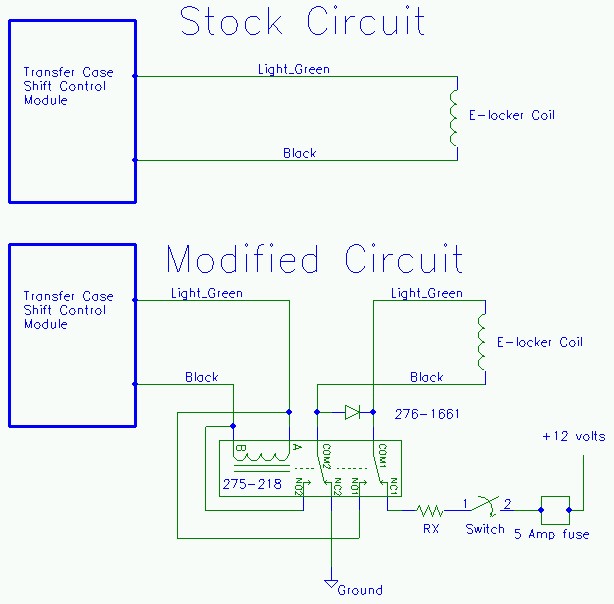

Here is the circuit I?m thinking about to remotely control the e-locker. First, there are many different circuits to do this function. I?m leaning this way because you only need a single wire to run to the remote control switch. When you use the normal stock e-lock switch, the light green wire gets +12 volts and the black wire gets tied to ground. This energizes the relay?s coil. The contacts connect the e-locker coil to the transfer case shift control module.
When the normal stock e-lock switch is selected to disable the e-lock, you can control the e-locker using the remote switch. When the switch is closed, +12 volts is applied and current flows through a 5 amp fuse, a resistor (depends on the black wire to ground resistance measurement), to the e-locker coil, and then to ground.
It?s probably best to not use both the normal stock e-lock switch and the new switch. If both switches are used, you go over 20 MPH, and the transfer case shift control module tries to deenergize the e-locker, the relay will open and your remote switch will supply power to keep the e-locker engaged. The concern is I don?t know what happens to the e-locker while the relay transitions from on to off.
The part numbers listed are Radio Shack part numbers. Do not eliminate the diode.

Your concern on this mod regarding using this override circuit and the stock circuit is valid. There is a missing link in your stock illustration that would be the interrupter or sensor that opens this circuit when certain conditions are met.
Implementing this mod would not be advised till after warrentee expiration.
