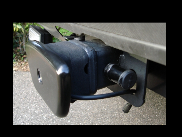

Do you have this much of a gap between your HitchCam and receiver?
