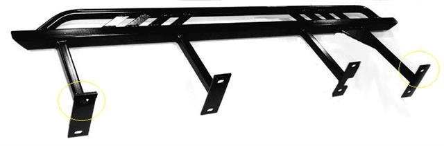

Bottom line, oldhiker's right....they're not gonna cause any serious damage. They will protect the vehicle. It would safe some $ if they could add a couple supports like the H3 sliders here - circled in yellow.
'03 H2

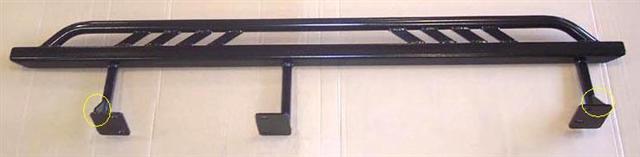

You can see that the H2 sliders don't have these extra braces....
'03 H2
