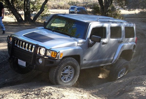

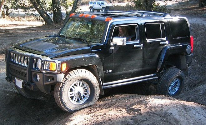

I can't wait till I have flex like this
  #59
Old 03-31-2007, 12:26 AM
Default Re: Torsion Bar Information
Doesn't look like much more than stock.

  #60
Old 03-31-2007, 12:35 AM
Yeah it does, we both have 33's in those pics, he's got 35's on and it still looks like more flex.
AND QUIT PEEING IN MY CHEERIOS DAMMIT!!!!
But it is kinda funny to see our trucks from sooooooo long ago.
