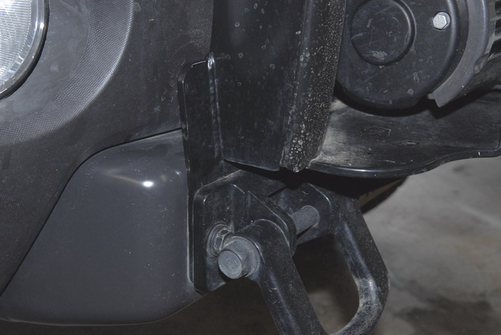

What??? 1600 lb pull & the bumper bent? Doesn't sound right....mine has handled some extreme pulls with no problems, until I really put a full load on it at a low angle.
The root of the problem seems to be the plates welded to the end of the frame for the D-ring attachment points; they are surprisingly thin at 3/16".
I've drawn up new plates to weld on, 3/8" with angle gussets to help prevent the bending. They're being laser-cut this week, will send out to anyone who wants them, no charge. It'll require pulling the bumper & grinding off the old ones, then re-welding new ones on. Also may include 2 supports to go from grill cage to body metal at upper grill.
Easy to fix that bend for now; I pulled my bumper (easy, 6 bolts, took an hour altogether), banged it out some from the inside, and used a pipe-wrench to straighten the mounting plates back up. I can't believe they only used 3/16 steel for those plates, beefing them up should fix the issue.
I want eveyone happy, and for things to work right, and nobody should have to think twice about pulling out the winch.

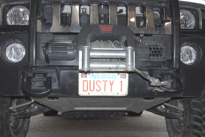

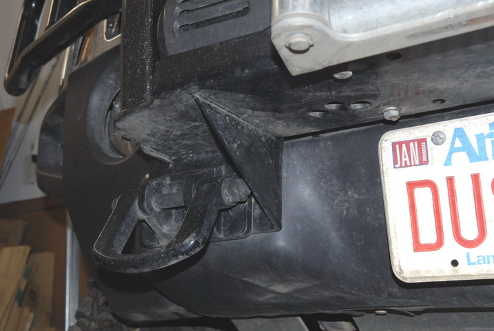

I have used this one a few times on some long hauls. Would this show anything you have not already figured out. I got mine before you made yours. I wanted at first to just have the mount. This is one of those from Teka Toys but Im not sure who made it. The brush guard and plate were welded together. I checked those backing plates after reading this thread.
