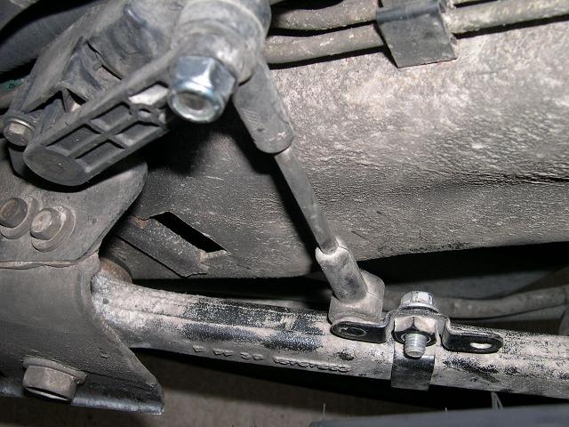

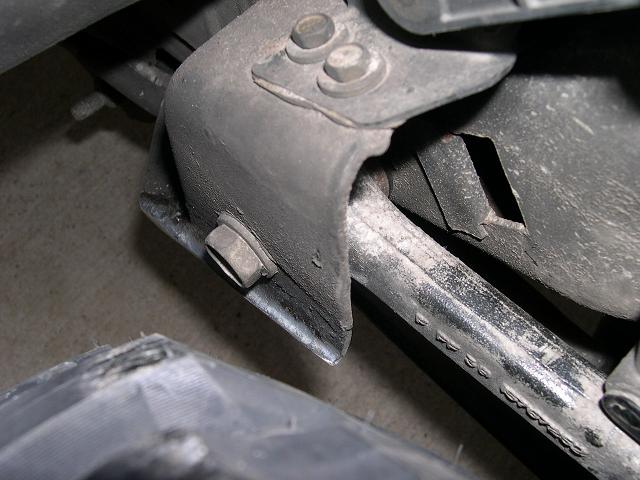

well here's an update. my buddy owns a firetruck shop in denton and he helped me out with moving the airbag sensor and cutting the lip on that one piece. here a some pics showing the final product, i havent painted the shiny parts yet.

we went ahead and flipped the lower part as well, that was VERY easy. actually, we swapped the the whole arms from the left side of the vehicle to the right and vice versa. turned out great and lots more clearance. all in all, took about 30 minutes to do all of it.

Awesome, what size and type of Screw did you use for both the top and bottom?
lol, i knew someone would ask. to be honest i have no idea. but it really didn't matter, because, you need to cut the remaining plastic post off, you can drill any size hole you want into the arm and put whatever size you want in there. i actually didn't even use a screw, we used a phillips head domed bolt and locknut. you just drill the hole to whatever size you are going to use. and for the bottom, you use the stock bolt thats already on there. hope that helps. if you have any questions when you are doing it, i can pm you my phone number to walk you through it.

truck looks great.... you think you could possibly just reuse that hard plastic pin that comes with the sensor or you had no choice to modifiy it?
yes, if you can figure out how to get if off without breaking it. i just didnt want to mess with it, so we cut if off.

ok, i found out what the bolt is.
it is a 5/16 stainless steel x 1.250 phillips panhead bolt with a stainless steel nylock nut. that bolt fits perfectly through the rubber link. hope that helps you all.
