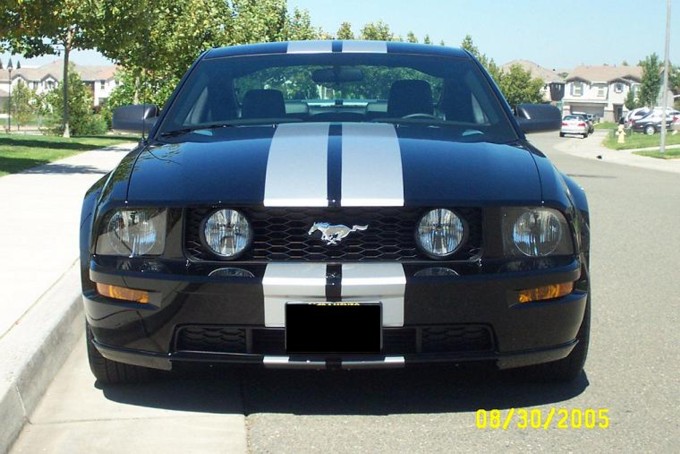

Spends most of her time in the garage. The H3 has 48K, the pony 8K, bought them within about 2 weeks of eachother.
I'll see if I can find some pics.
Edit: Found one
  #37
Old 04-19-2007, 05:43 PM
Default Re: To Turbo or to Supercharge, that is the question.
Her upgrades so far, Magnaflow exhaust, superchip w/CAI (brought the HP to 350), lowered, and some other cosmetic stuff.
