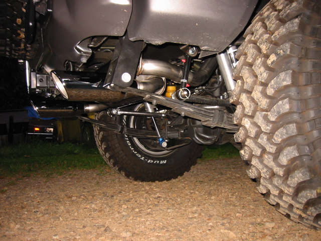

So here?s my take on the shackle lift and quick disconnects. I?ve been tracking down and putting together a list of the parts for awhile. Finally got everything and put it on this afternoon. Here?s what I used:
Shackles ? Warrior YJ rear 1.25? lift, part #WAR123 ? www.warriorproducts.com
These are 6" hole-to-hole, about 2.5" longer than stock. You can see how much beefier these are than the stockers. I actually bent one of the stock shackles at some point. Didn?t even notice until I took them off.
Bar Pin Eliminators ? Rocky Road Outfitters - http://www.rocky-road.com/zjbarpin.html
I wanted to match the rear shocks to the front but Bilstein doesn?t make the 5125 with a barpin. The BPE also moves the mounting point down about 1? to compensate for the shackle lift.
Swaybar Disconnects ? JKS Quicker Disconnects, WJ 0? lift front, part #3100 - http://store.jksmfg.com/merchant2/merchant.mvc?Screen=QRDISC&Store_Code=JKS01&Catego ry_Code=Swaybar_Disconnects
You can adjust the length on these and at their shortest are around 1? longer than the OEM endlinks.
Shocks ? Bilstein 5125, part #BE56248H5 - http://www.bilstein.com/offroad_5125.php
These have 10? of travel and are valved the same as the Cognito/Bilstein front shocks.

The install on all of this is pretty straightforward so I?m not going to bother going through all the steps. But here?s a couple shots of everything installed.
The bar pin eliminator
With the quick disconnect removed.
A couple ?after? measurements.
Bottom of front hanger = 13.5?
Hub to fender lip = 25?
To top of bumper = 35.5?

Is the 11 degree swivle of the connectors enough? I remember IPE needed washers because his connectors didn't have ball joints and because of this couldn't handle the angle without washers. Yours has some type of ball joint right?
I think they'll be fine. They have spherical bushings and have a collar at one end for the offset. They bottom flares out maybe a couple degrees. If becomes a problem I can always grind down the collar to get the endlinks more vertical. They are also greasable, so that will help with wear.
BTW, the stock ones weren't vertical either. They flared in at the bottom a couple degrees.

The ride is much better, on and off road. I haven't run with the swaybar disconnected yet (no need) but there's still a noticeable increase in flex with it connected. I didn't get any pics on the last trip (never bothered stopping to pose ) but I'll try next time out.
Now I just gotta install the new t-bars and level it out again.

I have the same disconnects. Copy pasted it from Sewie. They look great, work great and give you lots of flex even with them connected. My jack could not get the tires off the concrete. You must pull the the ABS wires from the plug in the fender wall. Otherwise the flex will break them. I noticed this when jacking up the rear tires.
I give Sewie a:
Thanks.
The ABS wires were one of the reasons I didn't bother to disco the swaybar on my last run. Did you reattach the cables to the fenderwall somehow? Or are they just dangling there?
