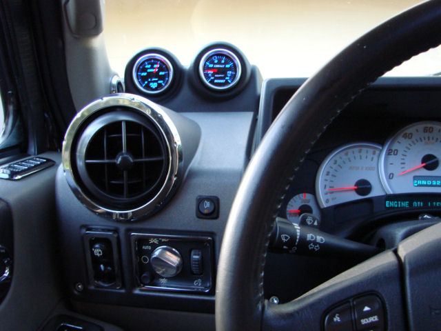

Hey guys. Just picked up BRUTE this afternoon in the pouring rain. Supercharger is awesome. No whine before its time, so they say and this whine is great. Added a dual gauge pod for boost and fuel pressure as well. Looks awesome. Sets over the drivers side ac vent. Pictures to come, hopefully tomorrow. Problem why it took so long was that I had them install MSD wires and coil packs, but the coil packs didn't fit, so they had to be reordered and the second set didn't fit either. We ended up reinstalling the oem ones..All this took at least an additional 4 days. Also had them install the PIAA horns that I had purchased a while back that I was a little hesitant about installing since they were not a direct replacement. The guys did it for me without a problem..It certainly pays to know what you are doing..They definitely are louder than the oem ones, which is what I wanted, without having to get an air horn. The supercharger kit came with a K&N filter so we just replaced the oem one with it and kept the original box..I'll probably keep it for now, but I have my eye on an Injen one which aesthetically looks better. especially since I like to enter car shows, I will see if it will work with the sc coupler..Hope to psot some pics tomorrow,Da BRUTE for the supercharger. An awesome piece of equipment

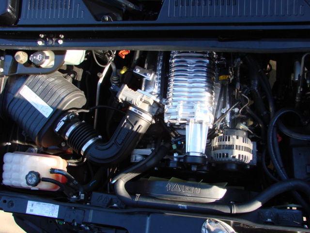

Well thanks to a beautiful S FL morning, I was able to detail the engine compartment and BRUTE and take some nice pics..Hope you enjoy them..BRUTE
File Type: jpg BOOST AND FUEL GAUGE POD VGA DSC02711.JPG (68.3 KB, 473 views)

I've been looking for a new airfilter too on my supercharged H2. I contacted Terry Pedicard the technician from Magnuson superchargers and he advised me to stay with stock air box. He says that they tested several setups on a dyno run with their supercharger system and all had less power than the stock box. This guy knows what he is talking about he has a lot of experience and he tested everything in identical test conditions.He says you can gain a few horses on non blown engines but not on supercharger applications. I'd rather believe him instead of the bull**** of guys that claim they can feel the difference of .5 % of power gain. All the talks about intake boxes and airfilters is merely bull****. I've seen a few really well documented articles with air box replacements and dyno proof before and after. None has convinced me. If you win 2 or 3 hp mostly you loose on torque. The factory box takes the air from the right side outside the engine compartment. All systems with a cone filter in the engine compartment suck hotter air and lose power. These systems are by definition worse than stock. It seems a contradiction but if your supercharger has to suck air through a smaller pipe with more resistance, you will get a small lowered air pressure in the aspiration duct and this will lower the temperature. So on blown application more intake resistance does not mean less power by definition. I'd think twice if you consider a new intake system for power gains.

Thanks. I know I am keeping the oem box for now and probably will just change the filter. What you say makes a great deal of sense. Especially on the supercharged ones.

Congrats on the s/c brute! I see you got the polished s/c. Looks great! Hey where did you get your guage pod and guages? I'm looking to add this to my H2 asap.

Thanks Griz. Your setup is by far the cleanest and neatest I have seen. Great Job!..The gauges and pod were ordered from autometer..link is
http://www.autometer.com/
I really like the cobalt blue gauges as they light up really neat at night..In addition to the boost gauge I opted for the fuel pressure, only because the shop recommended it..If the truth be known, I went for the BLING!! BRUTE

BRUTE, just realized that the guage pod you're using will block my new tweeets in the a-pillar, atleast the one on the driver side. Anyways, might have to find a better location for the guages, maybe something custom. Dropped $800 for a set of Focal mids/highs for the front. Don't wanna block that tweet! I like my music!

I have the same guage pod and aftermarket tweeters. Don't worry they will not block the sound at all.

SWEET! Had the same setup in my F250, but only I didn't have a guage pod blocking my driver tweet, only the freakin dash itself! Didn't really notice much, but didn't like it anyhow.
