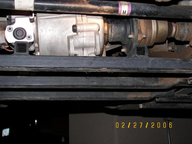

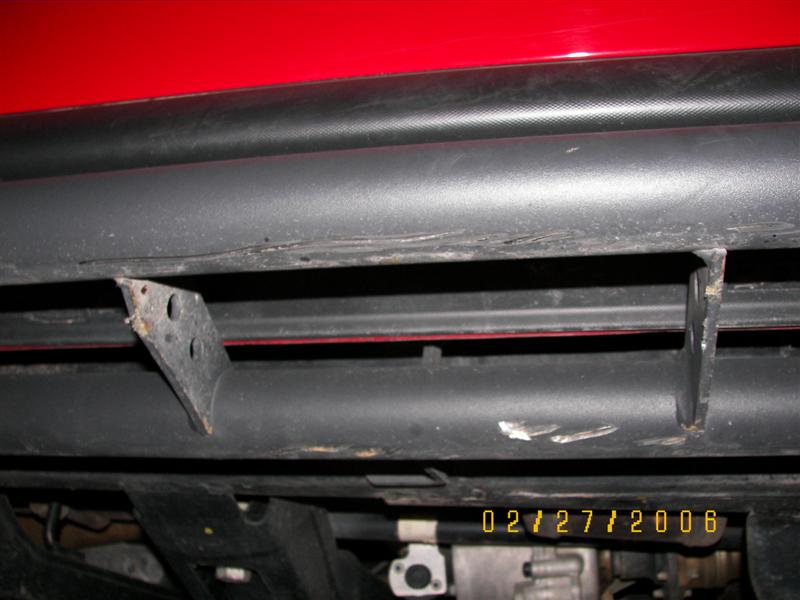

This a picture of the RP and UCP after Sunflower Mine Loop trail. I know the pictures are not that good but the stuff hanging from the UCP is metal not paint. Can you imagine how the aluminum transfer case would have faired.
If your going off road get the RP and UCP.

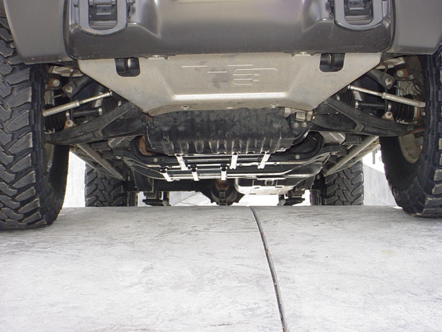

just thro on a set of 35's to get that inch back thats what i did . heres mine i will be putting the UC protection to use this weekend for the first time
Have fun putting the UCP to use. I put the MT/R 315's on last week and they really help off road. I would never go back to the 285's.
