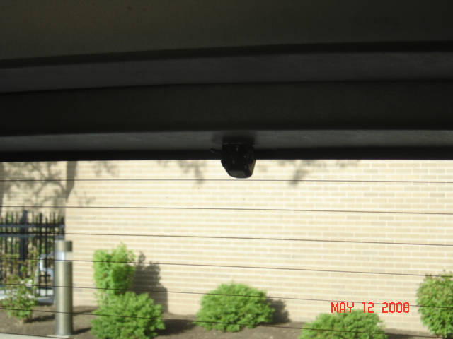

No idea what brand. It came with the Eclipse system.
But, I do know the best spot for it.
Old 05-12-2008, 02:44 PM
Default Re: Backup Camera
Totally weather proof and gets a fine picture.
Adam, Do you know the make of this cam. I really like how you've mounted it in the inside...cool. Is it possible for you to take a pic of the cam in motion say from the monitor??
