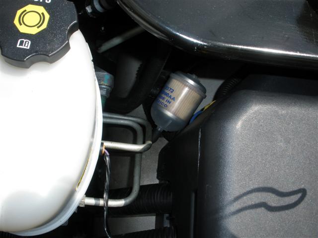

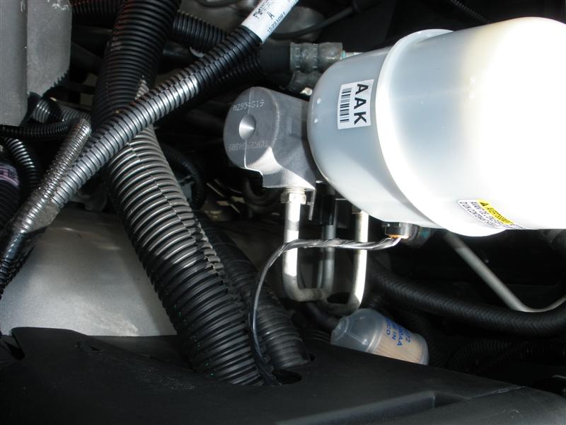

I just went through same thing on my 05. It didn't start till I jumped it a couple feet in the air. They replaced the vent first, but still was getting oil so they replaced the brake booster and everythings fine now. execpt the brake fluid ate the paint off my frame. They did cover it under my extended warranty.
