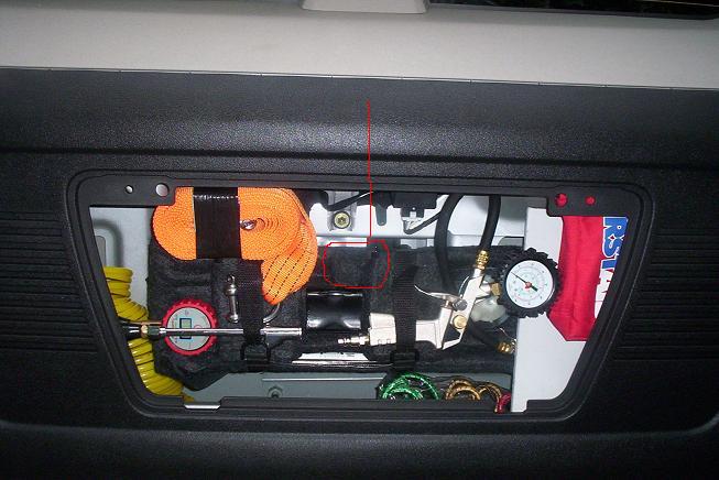

Mine was in a clear plastic envelope in the glove box.(I think it also included a card with a serial # if key was lost)
There is a little pocket on the carpeted material on the jack (in the jack cubby.. )where it belongs ,I would check there.
