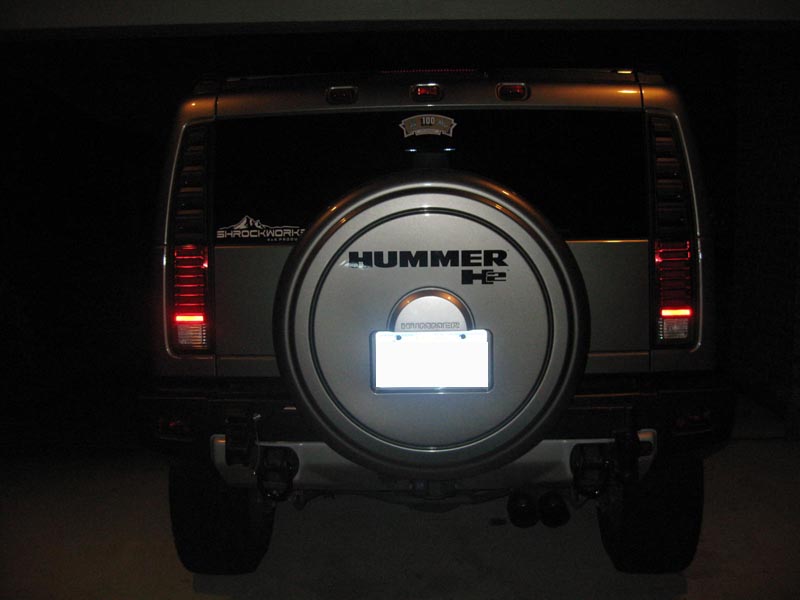

I wanted to go w/the factory look on my taillights, so I ordered the red (stock look)
Overall, its very easy install- takes about 10 mins each side...that's including time to take off the factory ones.
I also had to use the resistors ...as when I didn't have them, the blinkers were blinking way too fast.
The install on the lights was a simple "pull out the factory bulbs...(except the reverse bulb) and plug in the new LED wires directly to the wire(s).
The only gripe that I noticed was that when you have your turn signals on, the rear bumper light isn't synchronized w/the led blinker- it seems like it's almost synched, but it's off and on.
I wish there was a LED (factory look) rear bumper lights to make the look uniformed.
Overall, I'm satisfied with the purchase.
This pic is before.....

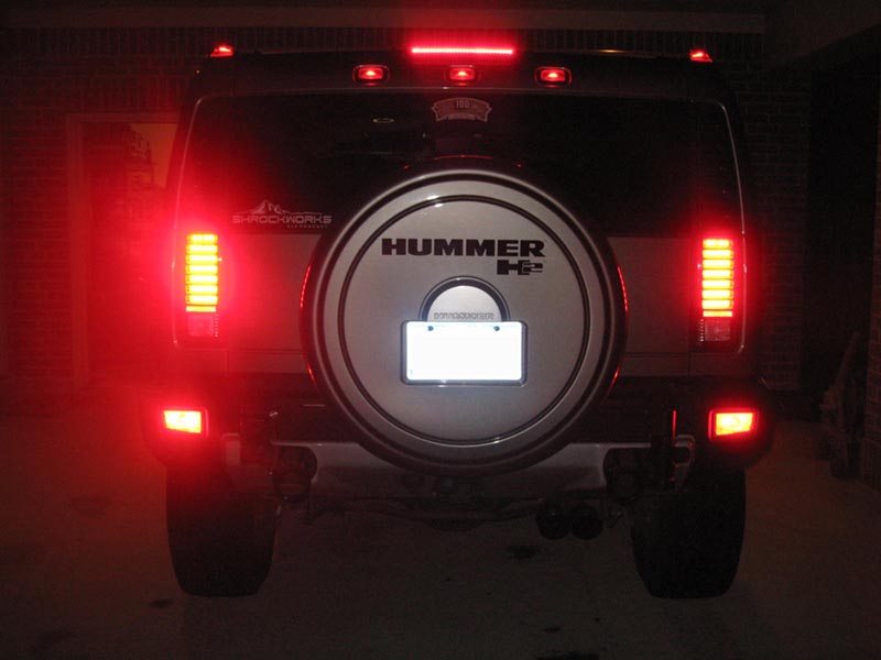

After w/the new lights-
95% satisified...would be 100% if the timing of the blinking synched up w/the rear bumper lights...like the factory ones...
but oh well.
