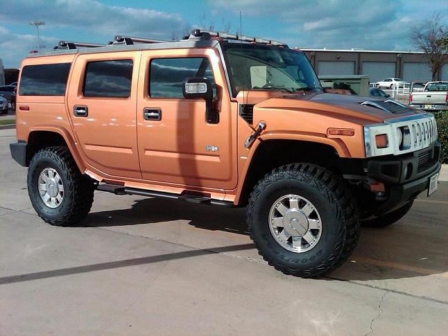

i just got my 37's mounted today....these are factory rims though...and they do rub the frame right behind the front tire, but only in full lock turn.

damn that looks sweet
