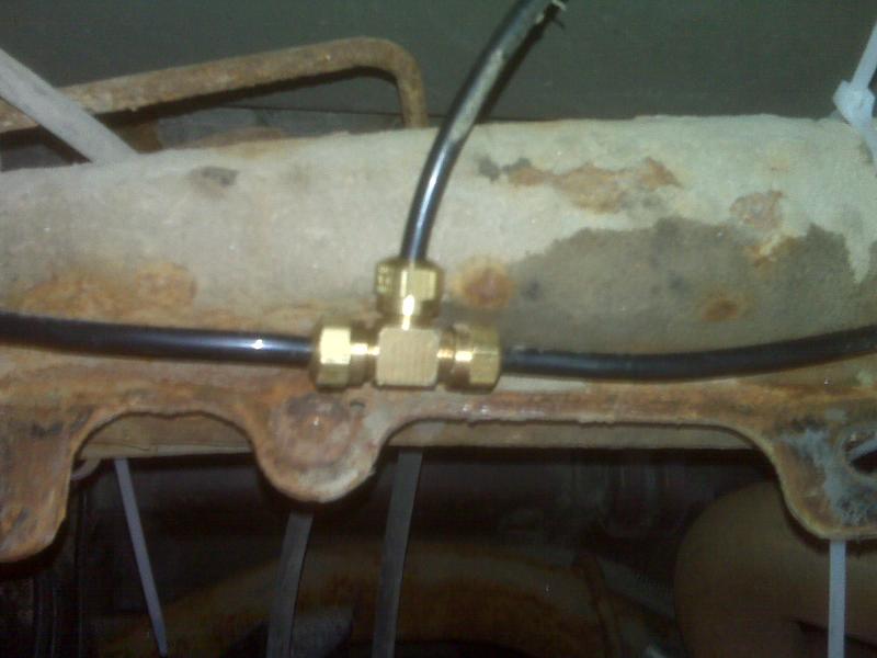

ALRIGHT! on my 5th try I remembered how to log in. Just wanted to say that my air suspension has been draggin for a couple of weeks . I unbolted the air compressor and tossed it in the trash then I joined three hoses together with a fitting. One hose from each airbag and one hose that leads up into the cargo area for hooking up to to fill tires. Then I stuck my shop air hose in fitting in cargo area and filled up my air bags. Walla! level hummer with air ride. Heres a pick maybe. doug

Try this?
Neat Idea.... But when the outside temp changes so will your ride height. Same as tires... Cold out side ..Need more air... Warm outside tire pressure goes up less air....
Maybe you could hook an air pressure gauge up to that line and fill till your rig is level..then note the pressure and then you'll be able to nail it agian as the temp changes.
Also don't forget that the up and down movement of the bag during operation down the road creates heat which will raise the pressure...
