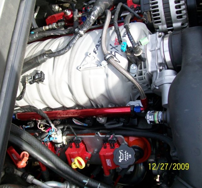

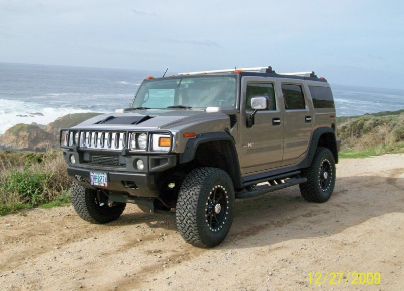

Got the 408 running on Christmas Day. Me and my brother drove it from Medford Oregon to Gardena California to ship it to Germany on the 26th. It ran great for the 750 mile trip. I am changing the gears from 4.10 to 4.56 to compensate for the 37s. It pulls hard and strong, especially from 5000-6200. I am going to have Allen Nelson retune the PCM to shift at 6500 at WOT.
Next mods are lower gears, Cognito tie rod kit and idler kit.
The engine sounds really nice, especially at 5000 to 6200.
I will make some youtube videos as soon as it gets to Germany.Name:  Hummer on HWY 1.jpg

Old 02-24-2010, 04:39 AM
Xotik H3 Xotik H3 is offline
Join Date: Jan 2007
Posts: 167
Xotik H3 is on a distinguished road
Default Re: 408 Hummer road test....Medford to LA
Damn that looks nice! I love the pic of the 408 in there too.
looks good. was that built using your factory engine or a LS1? That should make some good power
Old 02-26-2010, 08:55 PM
EuroHummer's Avatar
EuroHummer EuroHummer is offline
Join Date: Nov 2009
Location: Hambach, Germany
Posts: 78
EuroHummer is on a distinguished road
Used the factory 6.0
