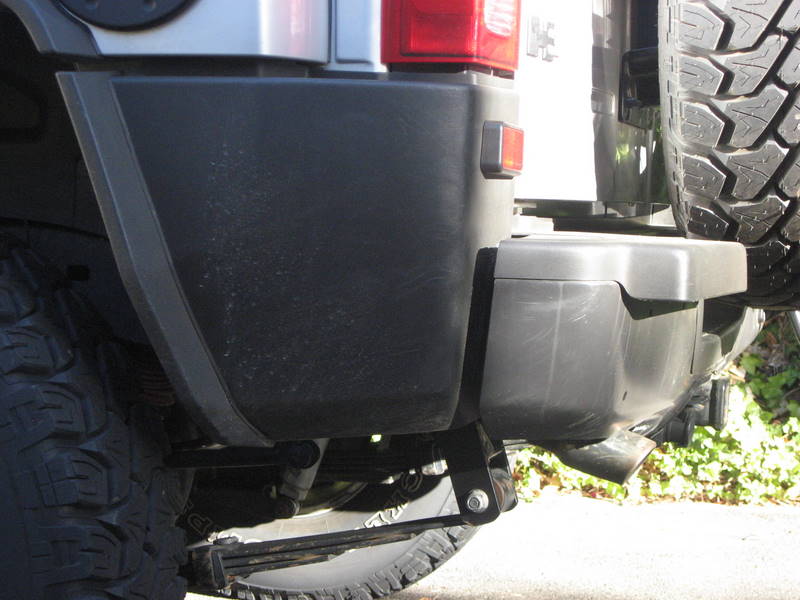

Were there gaps between the front bumper and the grille and between the rear bumper and the rear door after the body lift? If so, how did you fix it? I have been thinking about a one inch body lift but I don't know what trouble I will get into trying to get rid of gaps.

I never did anything about the gaps, to be honest I never actually noticed an issue.
Unless your putting 35" tyres on I wouldn't worry about the body lift, 1" on T-Bar and a longer rear shackels is better as you do also get a bit more ride height clearance at the front.
See attached pic and compare.
