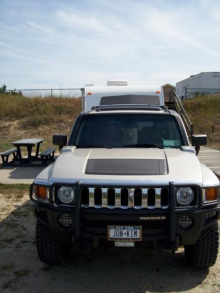

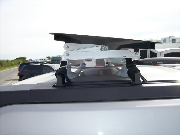

the deflector in the one pic.
its about 4 feet wide.
11.5 avg on my NM trip lots of hills
12.5 avg upstate some hills
13 flat ground.
That before the deflector.
I get a good 1.5 mpg better now with the deflector maybe up to 2 and notice its a little smoother going up those long steady hills.
Heres another pic from the side.
the 2nd one is in the down position for not towing, they recomend about apx 15 degrees when not towing so it doesnt cause lift
apx 45 when towing.
It comes with rain gutter hooks to mount at door opening.
I have it further back and use the roof rail tabs for mounting ,its a cleaner look.Name:  wing side.JPG
