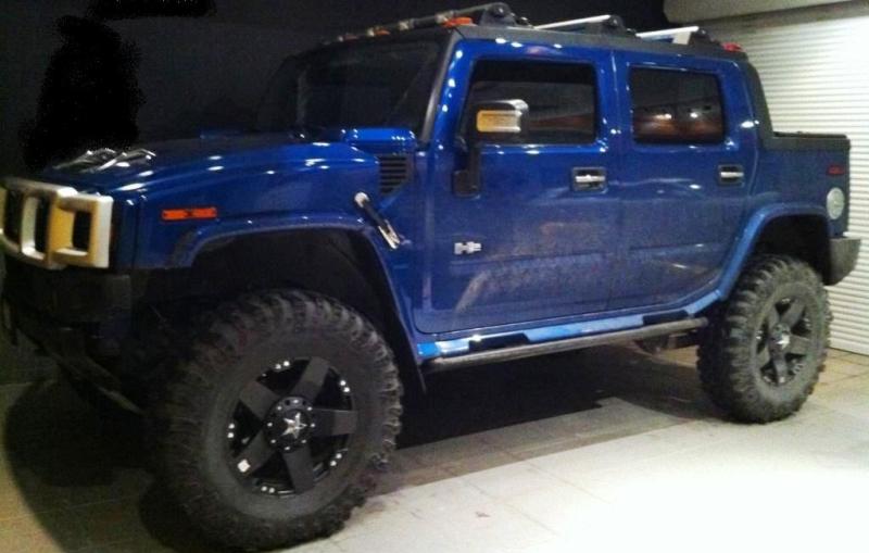

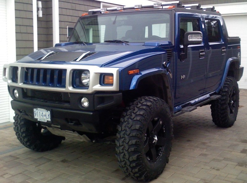

I installed the Rancho "short" links and my SUT was lowered just over 2".
With the long links I measured from the ground to the fender and my truck sat 50.5" at each corner. With the short links my truck sit's at 48" at each corner. I uncranked my torsion bars and my SUT rides very smooth now but I do need to get an alignment. I also rub when at full crank and would rub bad offroad! Hope this info helps you guys.

First pic is Rancho's LONG link
Second is Rancho's SHORT link
