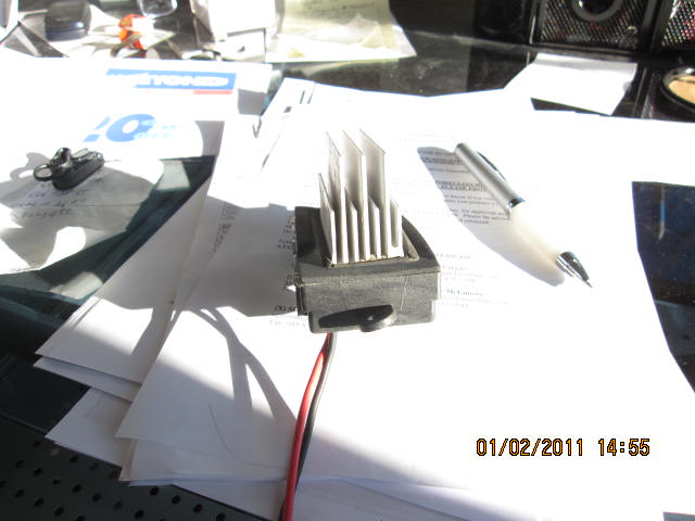

My heater fan went out the other day. It was acting sporadic and now it won't come on.
I've done some reading that lead me to check the relay/fuse- good to go. So I'm now under the dash and I can't seem to find the resistor module that I've seen during searches.
This is what I've pulled off the fan body. Name:  IMG_5731.JPG
I'm guessing this is the resistor module? The black and red wires go right into the back of this thing- no connector.
There are no burnt wires or other connectors.
One thing to note is while wiggling the red wire on the module end I did get the blower to blow just a little. Barely- and the fan was on high.
I can hear all the controls when changing from auto to manual or making changes in manual mode.
Any advice is appreciated.
***EDIT***
I finally found a picture of this thing to confirm it is the resistor module. Is there a way to test this thing? It's 138.00 on GM parts direct--I'd rather not order "hoping" that this is the problem since you cannot return items to gmpartsdirect.
