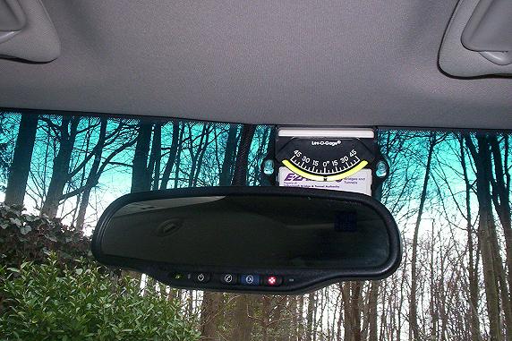

Originally posted by NEOCON1:
ok this is how i mounted the cheap $10.00 one . i like it . got to 30 degrees today on the happening
There is a problem with that setup. First lev-o-gauges are a marine product, second they have to be mounted on the 90degree vertical plane level with the vehicle. Obviously, yours leans a little which affects the reading (not that it really matters as for you, just when you compare notes to what others might be doing). Third, the lev-o-gauge, due to this reason, has extremely limited mounting options.
The tilt-meter from trail-duty is simply the best, most accurate there is. The UK one, I am not familiar with, but the other mechanical gauges are junk.

lets say it is mounted perfectly vertical . when you are on an incline and sideslope together it would never be vertical . these marine ones will give a reading that should be within 5 degrees of true . when sailing you are pitching and yawing at the same time so should still be accurate +/- 5 degrees . i just want it to calm me down win the seat is up my a$$ but thanks for all the tips i will not go by gauge alone but is just another tool for having a rough idea of side slope degree . thanx again
No, you are right. It's a tool for use to compare from one situation to the next. Since your setup while wheeling changes (actual CoG) and whatnot, it doesn't have to be perfectly accurate. It's just something to glance at and give you an idea of where you are in the grand scheme of things because everybody's pucker factor differs.
I was simply mentioning that further you get from vertical in the mounting, the less accurate it will be. So much so that at one point, it will give you a much lower reading to begin with and then shoot to a high reading without venturing very long in the middle.

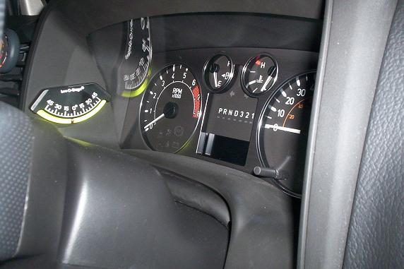

NEOCON1 I mounted it were you have yours with velcro.I used my ezpass bracket.I think it looks better there also.

fourfourto's Avatar
I also put a piece of velcro on dash so I can quickly move it for foward /back angle.Just line up the velcro and should be level even if your not on level ground at the time.also can be moved back to windshied by lining up the velcro even if your not level.

fourfourto's Avatar
mounted on dash again also with the velcro mount you hav a little wiggle room for offset adjustments as needed.
