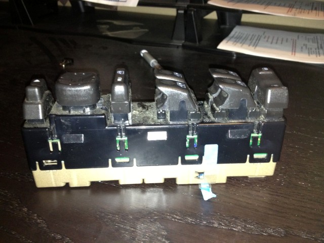

Just sitting here thinking... this poped out at me-
The heated Seat switches are momentary contact switches and are inputs to the driver and passenger door modules.
does the physical button face seem loose? Like the spring broke behind it. If the spring broke and its not holding that button open...as you drive around it could be rattling around closing the contact- activating the system.

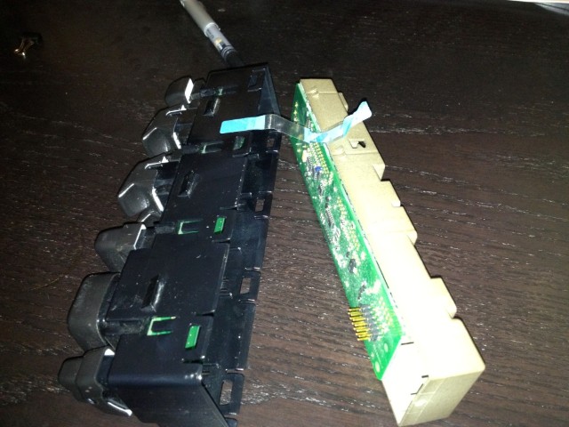

Here is the input to the drive door module-
Old 10-20-2012, 10:04 PM
[__--MUD--__]'s Avatar
[__--MUD--__] [__--MUD--__] is offline
Join Date: Dec 2007
Posts: 705
[__--MUD--__] is on a distinguished road
Default Re: Seat heater
Pin #3 & #9 are the actual on/off signals.
In theory, if those were disconnected- you have removed the physical input activators and kept the function indicators operational- Switch is disabled, but you can still see if they are on/off.
Door module communicates to the seat module throught the data bus. Like that heated seat option activated through the bypass module for the remote start...I "think" it contacts the seat module directly through the bus. Dont believe it sends any signal to the door module.

Good call, never thought of that myself
