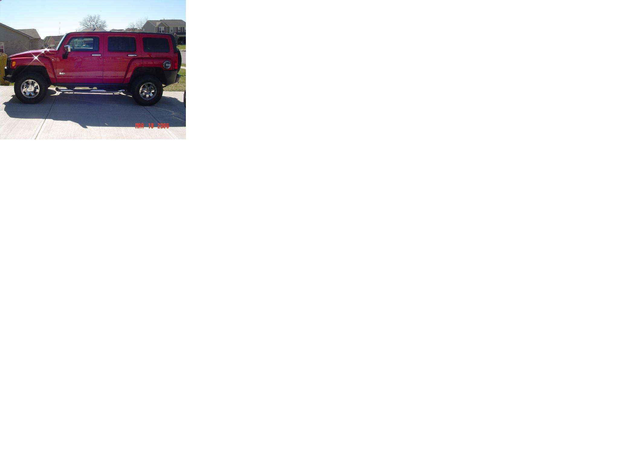

Here is the completed Picture of my Ride.
