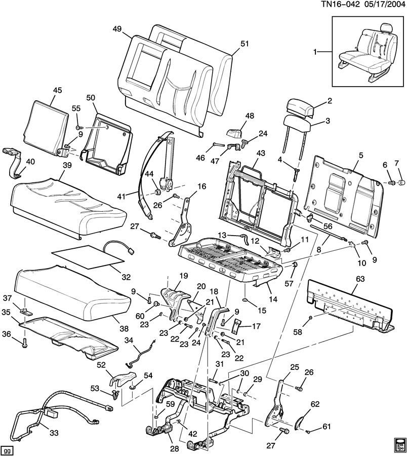

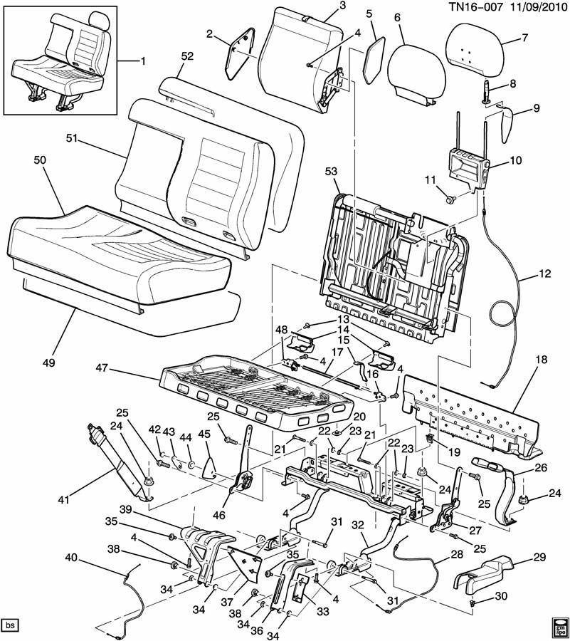

As you research this...keep in mind that the rear seat in an '03 differs from the rear seat in the rest of the original interior model years. I don't know if it impacts the mounting locations or anything else that you'd be worried about; but figured it was worth a mention. I know they changed 'something.' See diagrams below.
One interesting thing...the 'riser' for the 04-07 H2s (PN 88941240), is listed as a cross platform part used on 3500s, Sierras, Silverados, Yukons, etc. So...if the bolt pattern didn't change on the deuce from 03 to 04 you might be able to pull a set of rear captains chairs out of a Denali or Escalade and have them bolt right up. http://parts.nalleygmc.com/products/.../88941240.html
'03 diagram
'05-07 diagram

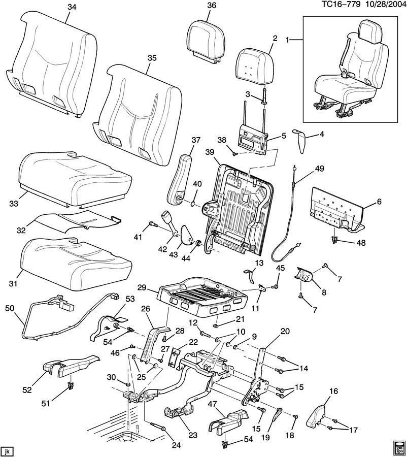

Here's the Yukon rear bucket...I bet it'd fit:
CNTRY

I've had my 60 half out for a couple years now and didn't even notice the carpet flap (if that's what you're referring to). I eventually put a big HUMMER mat across the whole thing. You could easily find a small mat to fit between two bucket seats.
If you're referring to #s 18 and 63 in the H2 diagrams...the plastic 'flap' on the back of the seat designed to cover the gap to the hinges when the seat is flat...no worries there either. The Yukon seat has shorter ones, #6 in the Yukon diagram. Worst case, if the clips don't line up you could just trim the H2 piece short. I pulled mine altogether so I could use the bolts as a Hi-Lift mount.

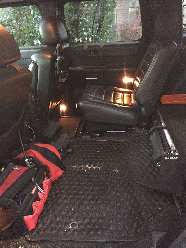

Yeah...it was a GREAT time...a whole day of wheelin', winchin', slippin' and slidin'....the crowd going wild...topless girls on the tree line jumpin' up and down...
...and as the muddy water and slop gushed up over the hood, and splashed up the windshield, I looked to my right and thought, "sh!t...(sigh)...my windows're down." Reports from the sideline indicated that you could actually see the cartoon thought-bubble appear over my head with those words.
You should have seen the front seats, and doors, and dash, and ceiling...everything. It looked BEAUTIFUL! That little bit in the pic is all that's left...from our April RC run. The truck don't get cleaned much...lol.
