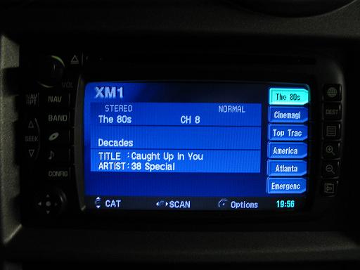

I bought the kit from gmpartsdirect.com. Everything installed with no problem.
It works properly through both the DVD/NAV system and the steering wheel controls. The song names and station names display on the NAV display and you get 12 presets on the radio, XM 1 and XM 2.

I just installed my XM Kit!
As BalanceMan said, works fine. More later...

Very nice picture Klaus. Looks great.

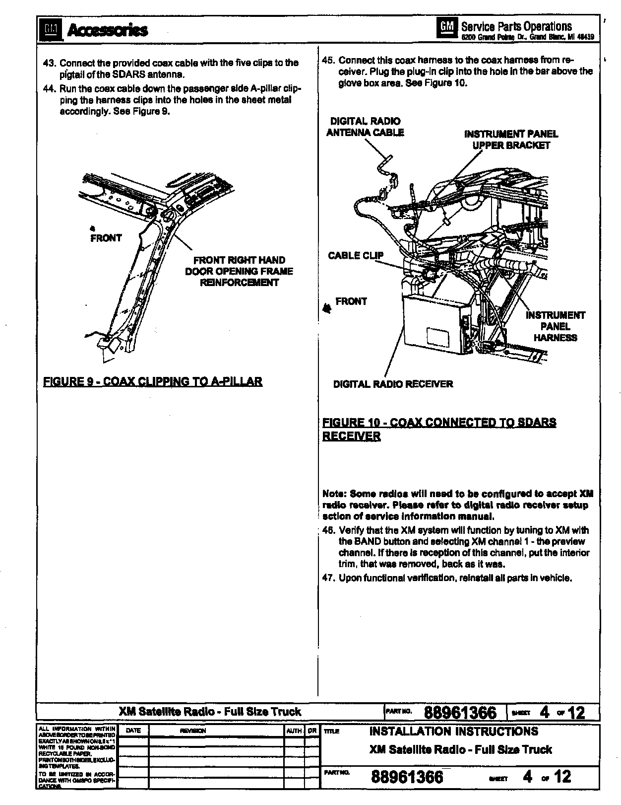

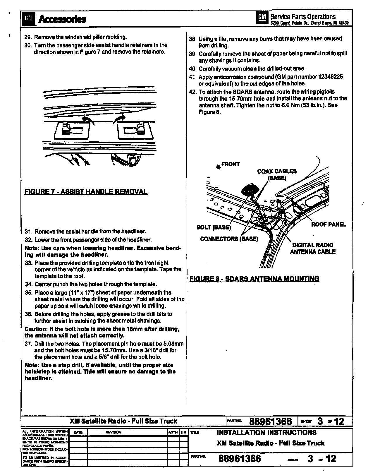

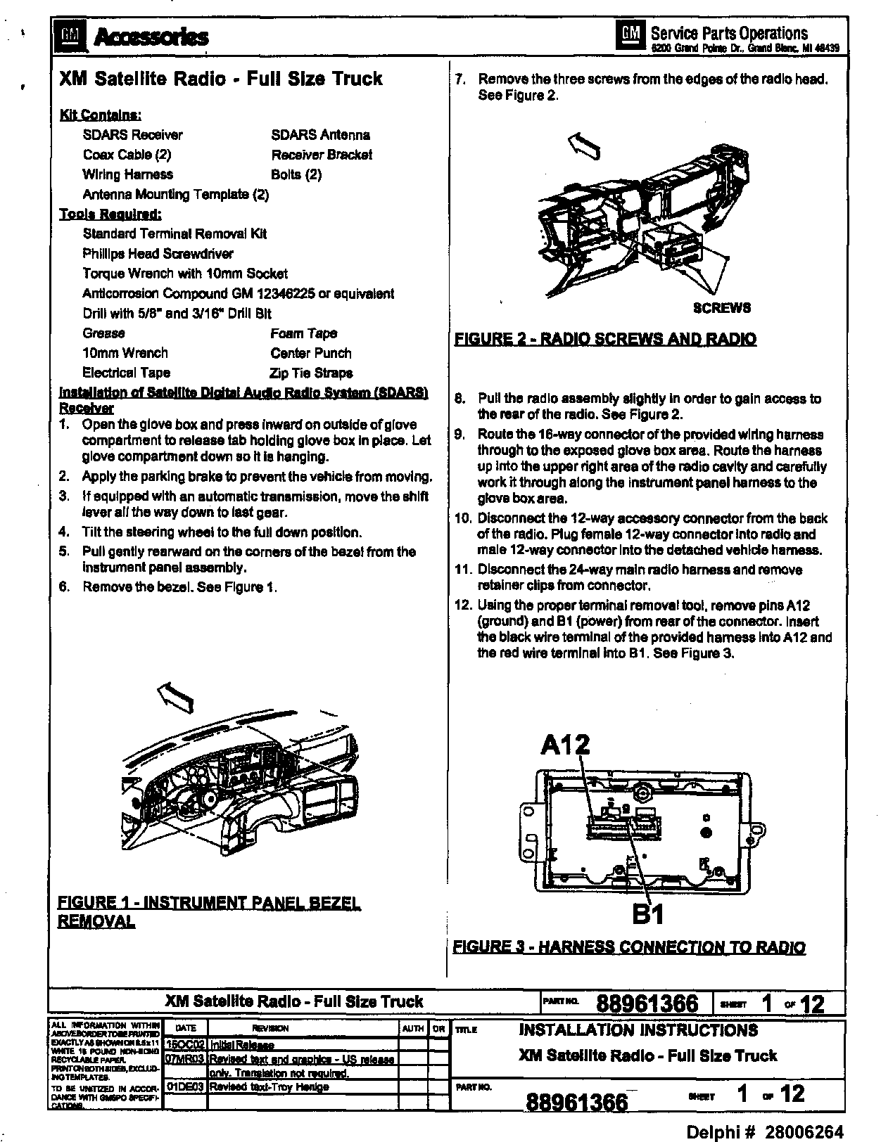

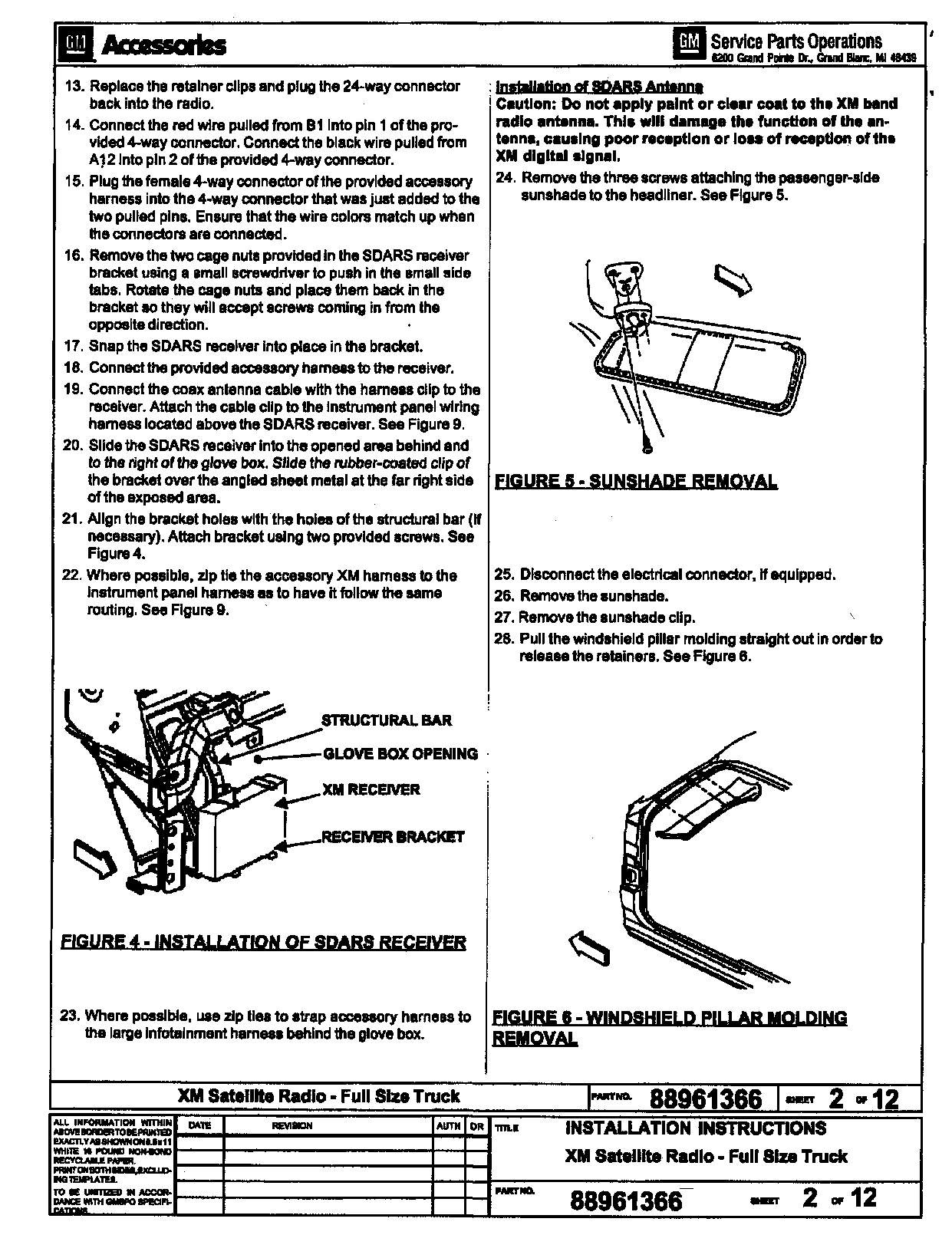

Here are scans of the GM XM Kit's instructions.
1

2

3
