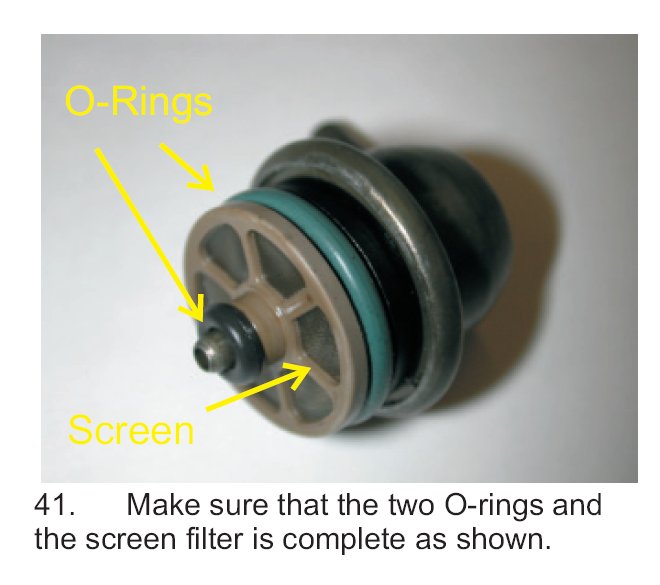

One common mistake is that one of the O-rings are missing on the fuel pressure regulator.

klaus, thanks for your pointer; i will double check that. i checked the fuelpreassure which checks in at 60psi, but i did not chek the fuel preassure regulator yet. if you have any other ideas....please!

Sounds like Klaus is right, the O-rings might be missing on the fuel pressure regulator. You woll still have pressure in the rail but not the correct pressure at all injectors. Remove it relube the O-rings and carfully reinstall it. We have installed a few of the Magnachargers and have had this problem one time. BIG-C

Klaus, Circuitguy; i will defenitely check the o-rings on monday. that at least gives me hope again that i did not screw it up totally.
