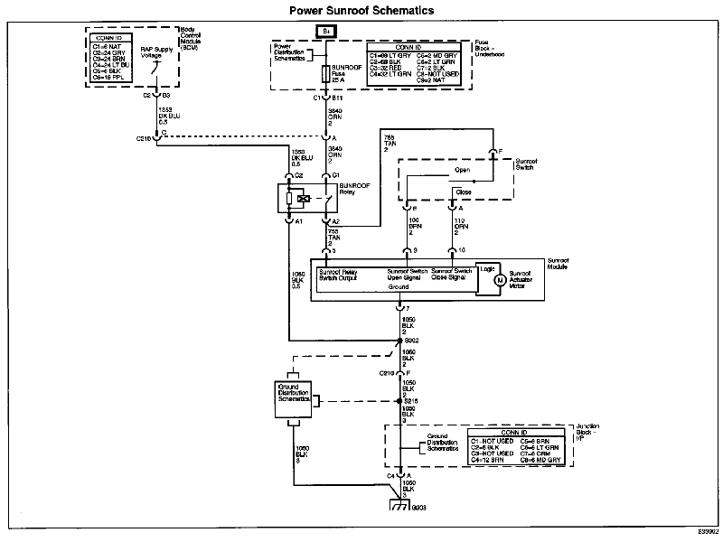

Las Vegas,
Put mine in today and it works well, but I noticed when it moves to auto close, it stops before it gets all the way in and does not seal. In fact when it opens it open relatively fast, but on close it’s slow.... If I assist the sunroof with my hand by applying pressure the sunroof will close all the way and seal.
Thoughts?
  #71
Old 03-20-2005, 01:13 AM
LasVegas LasVegas is offline
Join Date: Aug 2003
Location: \"Lost Wages\"
Posts: 1,150
LasVegas is off the scale
<BLOCKQUOTE class="ip-ubbcode-quote"><div class="ip-ubbcode-quote-title">quote:</div><div class="ip-ubbcode-quote-content">Originally posted by JMV1210:
Las Vegas,
Thoughts? </div></BLOCKQUOTE>I assume you are certain this didn't exist before installing the express module. If not, say so. With that said, the only thing that might cause this is low voltage/current - poor connections. The only other possibility would be a defective module but I doubt that. I would start by checking the wiring sequence per my install wire colors & their instructions. Be certain the correct wires are on the correct side i.e. motor side - switch side. Then I would check ALL the connections you made for good solid contact. Redo them if necessary. Did you use quick connectors? They can be a little tricky. If that doesn't correct the problem, bypass the AutoLoc system and see if it's still slow closing. If it isn't at least you've isolated the problem to the AutoLoc (or your install). You'll need to resolve this because continued use at low voltage/current can damage the motor. Nobody else has experienced this problem. Let me know what you find.
Jonahs
  #72
Old 03-20-2005, 02:58 PM
Join Date: Aug 2003
Posts: 1,150
MNV1210 ... I've checked the sunroof wiring diagram and don't really see how the AutoLoc could cause the problem you're describing. Do the things above and let me know. Here's the wiring diagram.

Dear JMV210,
I haven't put one of these in, but will order one today. But it sounds like you are having a resistance problem. This could come from a few places. The sunroof might need lubrication or have a loose or bent part. There could be dirt or crushed leaves in the mechanism. The sensitivity on the WC1000's load sensor might be set too high or faulty. Not having seen one, I don't know if it is adjustable. You may want to ask the manufacturer. Otherwise, just tell them it is defective and ask for a replacement.

When I intially installed mine i had trouble with it opening but would close well. I did as Vegas said and went back with a meter and checked voltage at connections and the open side voltage would vary as I moved wire around. Rewired and worked perfect. The way it acted and having just installed i suspected My work first. The quick connects have for Me always been problamatic and I tossed them and went with inline connect to assure I had connections and all is OK.
