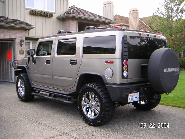

11-29-2005, 12:06 AM
Posts: 70
hey Alec,
From your "punk" comment, I can only assume that you are either still waiting to graduate from High School or you've watched too many Clint Eastwood flics and your brain has gone soft...
A perfect combination of safety and looks Paragon. Where can I order these from?
