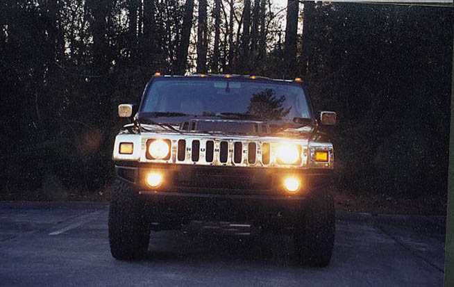

AL MOORE AL  MOORE is offline
Location: LAUREL, MS, USA
Posts: 102
AL  MOORE is off the scale
DRL PHOTO
"Follow the white rabit" .. Matrix 1999
\"Follow the white rabbit...\" Morpheus 1999....... It is finished.

Very clear and easy instructions. Great job. Even I figured it out as soon as I opened the fuse box. I stopped the task at the last minute because I wanted to think through 1/ if I want all the X'mas lights on during day driving, 2/ I can no longer use parking lites for longer period because DRL will be on too. 3/ other issues related specifically to my Hummer and usage.
B Moore, what do you mean: "I went with the relay kit from RICKS that you suggested.($34.00)" I read through NSXTC's posts several times but did not find such suggestion anywhere.

Great Job NSXTC...David I believe.
Lights work great as you speced...I will put in a switch whe the weather warms up.
Anyone know why there are 2 filaments in the DRL's?....I only get one light level...the lower one. How do we get the brighter one to light up?
