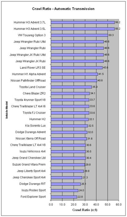

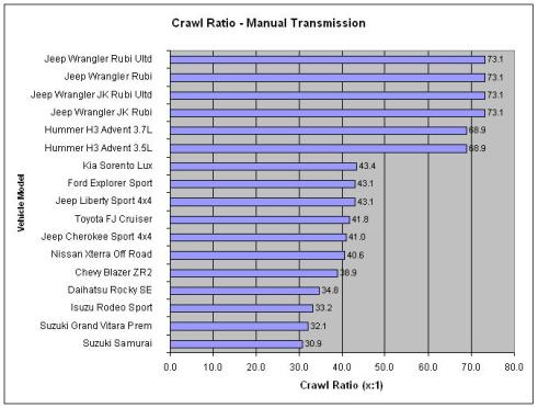

Originally Posted by GotSandH3
69:1 sounds like a great ratio. How does that compare to brands such as Jeeps and Toyotas??
It's best in class for 2006 models, but the 2006 JK Rubicon Ultd will beat it next year. The source I used for this graph supplied different numbers than the ones in this thread. I'll update them when I get a chance.

In the Automatic, the H3 will have best in class crawl ratio bar none. (Here are some updated graphs ... easier to read.

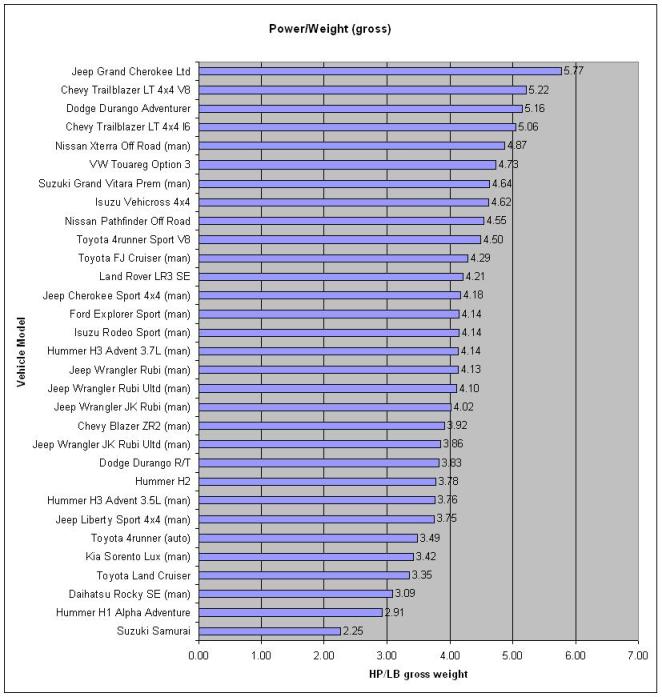

Wisha, can you do a power to weight ratio comparison??
Sure, but imho you have to factor in the gearing to get the whole picture. Here ya go.

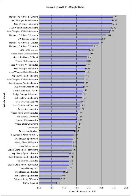

Here's a chart for Geared Crawl HP to Weight ratio

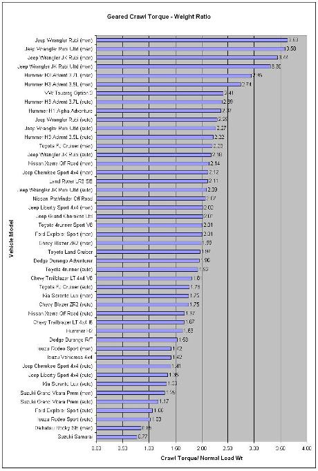

Here's a look at the Geared Torque - Weight ratio

THAT"S more like it!!!
