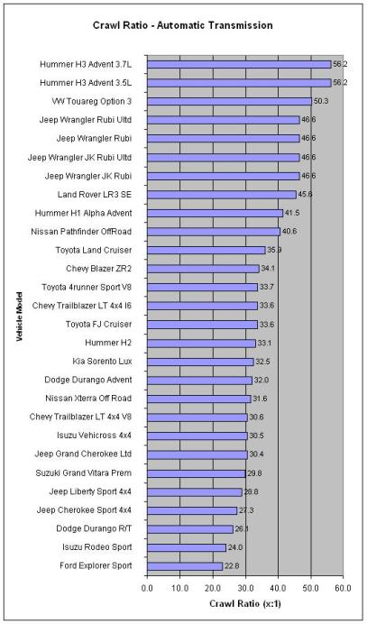

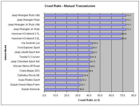

It's best in class for 2006 models, but the 2006 JK Rubicon Ultd will beat it next year. The source I used for this graph supplied different numbers than the ones in this thread. I'll update them when I get a chance.

In the Automatic, the H3 will have best in class crawl ratio bar none. (Here are some updated graphs ... easier to read.

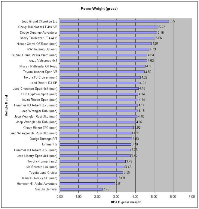

Wisha, can you do a power to weight ratio comparison??
Sure, but imho you have to factor in the gearing to get the whole picture. Here ya go.
