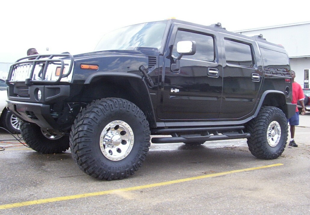

Old 10-24-2003, 05:29 PM
ANGELO D. ANGELO D. is offline
Location: SALINAS, CA, USA
Posts: 49
ANGELO D. is off the scale
PICTURE OF MY H2 WITH PROCOMP WHEELS AND 37IN MTR.

PhilD, The wheels I went with are pro comp
exterrain, 17in/10in, I had these wheels powder coated black. You would have plenty of room with
13.50in tires because my 12.5in tires have over 4inches of clearance when tires are turned in all the way. good luck.
